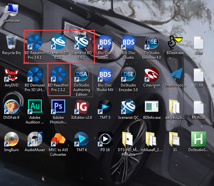

    how i can keep both scenarist bd version in same OS ? i have windows 7 64 bit. And BD-ReAuthor 2.3.2 works only Scenarist BD 5.3.2.
    I want to install Scenarist 5.3.2 for bd-reauthor and Scenarist 5.7.2 for 3D BD. I need them in same OS, is that possible ?
    BD-Re author 2.3.2 only gives project for 5.3.2, thats why i need to keep scenarist 5.3.2
    thanks

  7. #425
  8. #426

    @tianzi,
    thats great but how did you do it ? if you share with me, i will be happy. thanks
    это замечательно, но как ты это сделал? Если вы поделитесь со мной, я буду рад. благодаря
